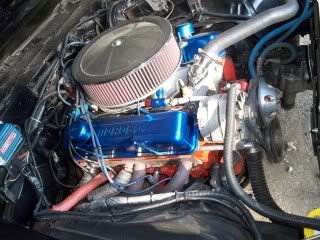

This is a picture the appraiser took of it in Bend. It has a built 377.
400 block bored 40 over
KB flat top forged pistons
6 inch Lunati I-beam rods.
cast crank ?
Dart Iron Eagle heads 2.05/1.60
Moroso Roller rockers w/ stud girdles
Weiand Team G single plain intake
Lunati cam can remember the grind
Speed demon carb

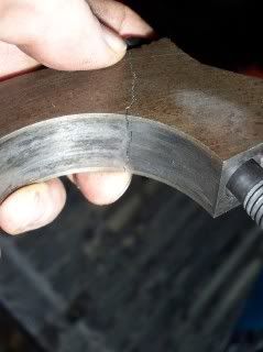

This is the cracked main causing my oil problems

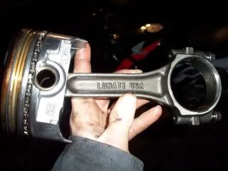

My pistons

We believe the cracked main was caused by the 12 or so :1 comp and pump gas...BUMMER. I didn't realize I had such crazy comp. Didn't really hear or feel the detonation either.
