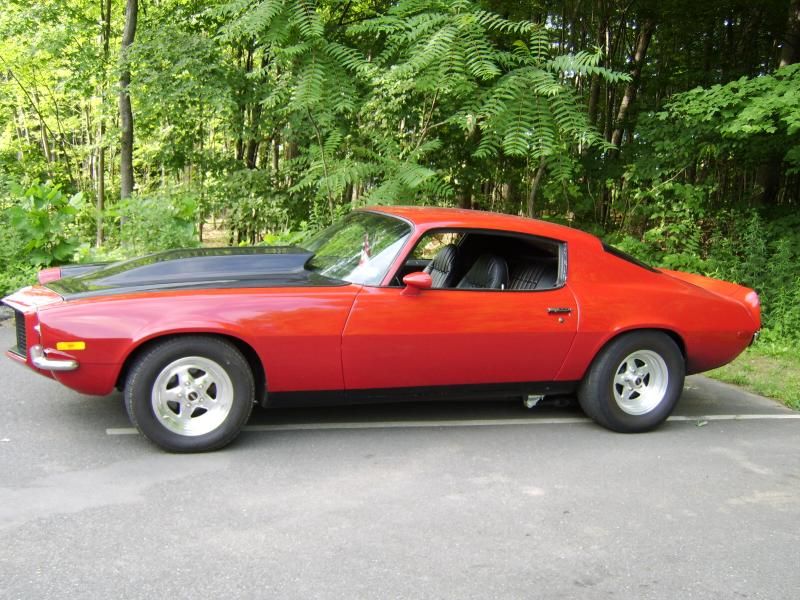

SBC iron heads, Al intake
BBC w/ Al heads and intake, same coil springs
